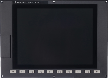

22 PLUS Series
22MA PLUS
-Equipped with Yaskawa serial bus communication Simpler System More expandable -Easier to install -Provide good Synchronous Control.
New design of new generation
New design of physical appearanceOpen bus servo communication, support Mechatrolink 3 and EtherCAT Focus on the pursuit of higher confidence level
Beyond their own, upgrade their controller performance
CPU performance, BPT performance increased by 20%, significantly enhanced short single-section mold and machining capacity of products
High speed spindle orientation function (HPCC)
HPCC function fits the discontinuous blocks into a smooth-curve path, and this will enhance the machining precision and reduce the mechanical shock.
SPA2.0(ZPEC) Servo Delay Compensation Level Up
-Enhance the precision of arc and corner
-Improve the path symmetry
-Advance the ability to resist the resonance of machines

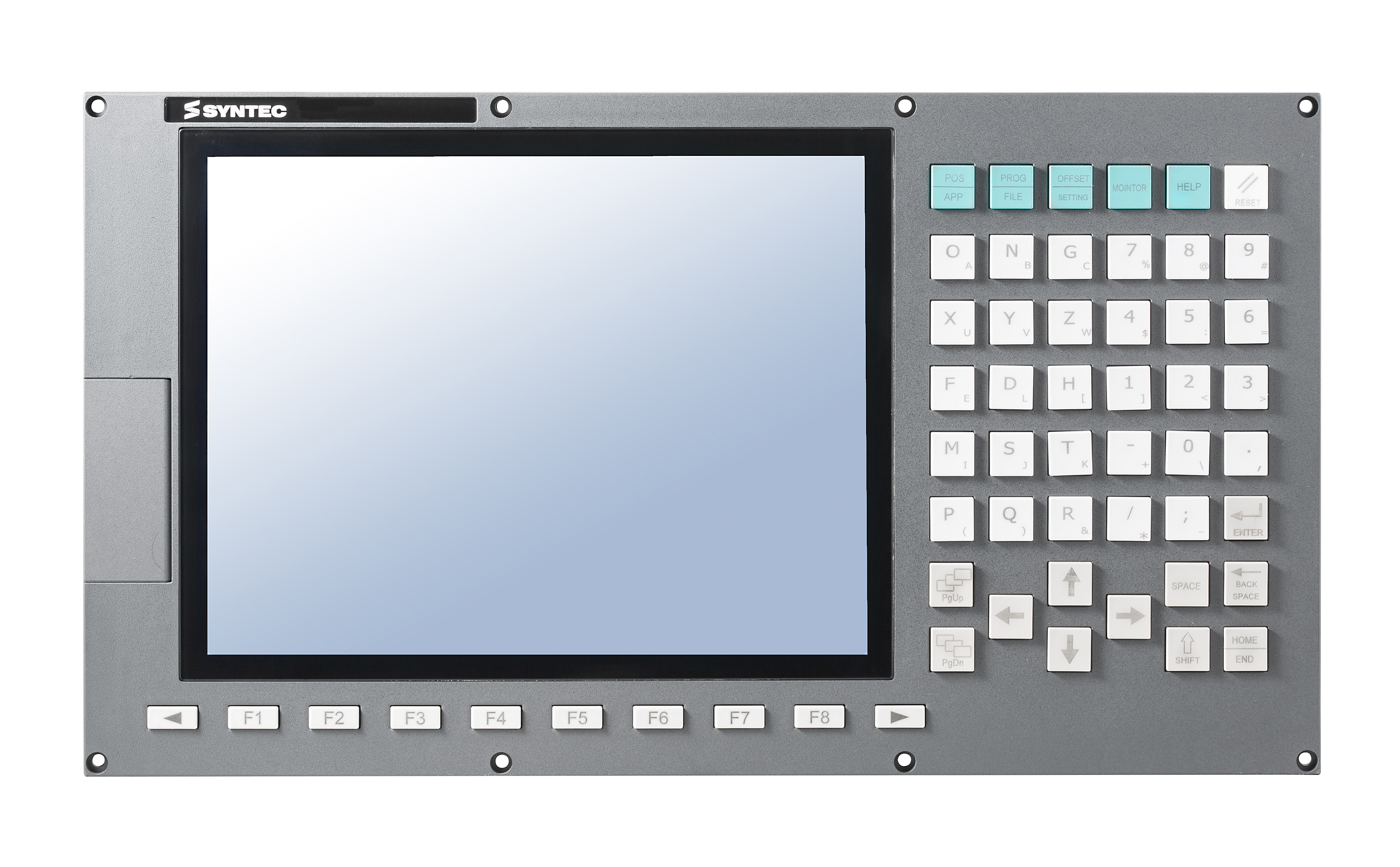

22 PLUS Series
PRODUCT
Model22MAPLUS
Axis no.6
DA
Inclined Plane Process
HPCC

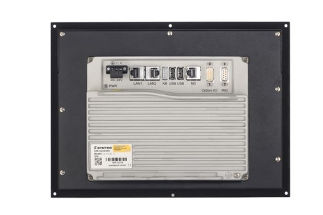

Max I/O64/64(RIO、M3IO)
Display8"/10.4"/15"
ServoM3/EtherCAT
ConnectionEthernet/RS485/SRI
Multi-Program No.2
RAM4GB
RTCP-
